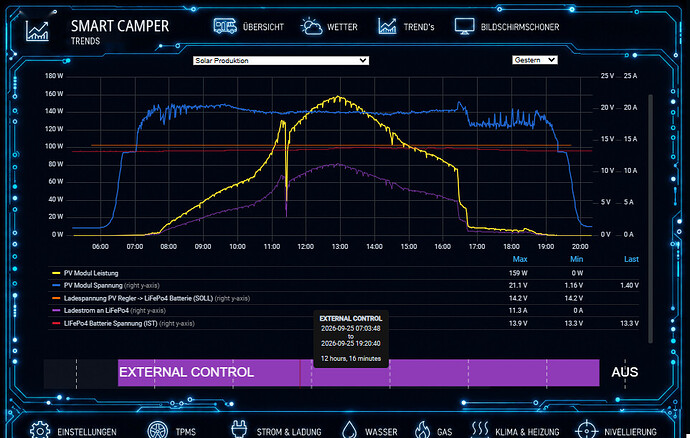

Good morning everyone, does anyone have an idea why my solar charge controller (MPPT 100/30 – with 360Wp PV modules) is starting to cycle?
It makes no difference whether it happens early in the morning or throughout the entire day. The solar charge controller has been installed in the vehicle with this configuration since mid-May and, in my opinion, did not exhibit this behaviour before.

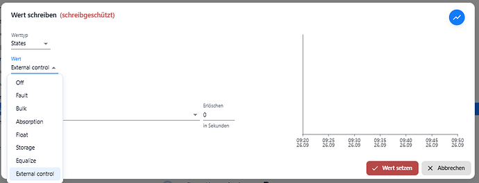

The cycling seems to have started around the time the SuperVolt Pro LiFePo battery was installed, which is now connected to the Cerbo via CAN bus as the “control variable”, with its BMS determining the charging behaviour (hence External Control). On the controller itself, the LEDs for BULK, Absorbation and Float are still flashing. However, the Cerbo no longer registers these mode changes in its “State” data point, but instead controls it via “External Control”.

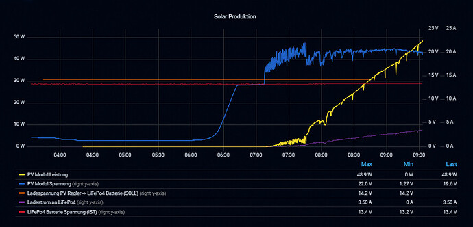

The solar controller cycles exactly every 10 minutes. Are these cycles normal and did I simply not notice them before, or is this behaviour something that should be stopped – and if so, HOW?
There are already quite a few threads on this; it’s normal. The MPPT performs an MPP scan every 10 minutes, during which the power is briefly reduced to 0.
