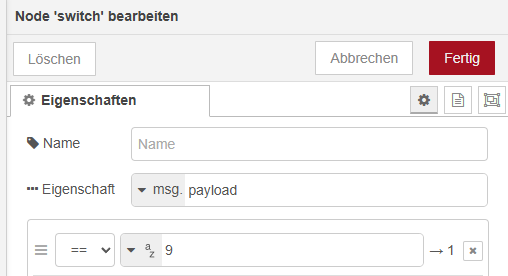

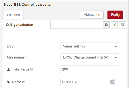

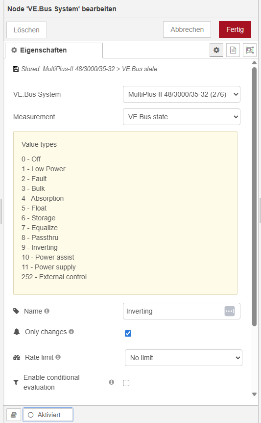

I have CCL = 0 in Summer so that only the MPPT´s are charging the battery (DC-feed-in = active).
Now in Grid-lost event, charging stop´s, so i would do the following:
When Multiplus in “Inverter-mode” > set CCL = 200
Is this Flow correct?
_aktuell/20260319553326.png
_aktuell/20260319927603.png
_aktuell/20260319750813.png
_aktuell/20260319807100.png
What does happen when the Multiplus is NOT in Inverting-Mode? Can i just reset CCL = 0 manually in the remote-control?
Is there an option to reset CCL automatically to the value it had before when the Multiplus goes back from inverter to grid-mode?

I have it:
Instead of a “switch” i have to set a “function” with following code:
if (msg.payload == 9) {
msg.payload = 200;
return msg;
