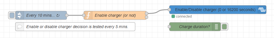

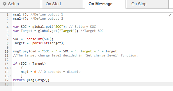

Can anyone work this one out?
If I send msg1.payload = 10808 on it’s own line it works. If I run the line msg1.payload = 10808 from within the { } then it throws this fault!
Any ideas?
Paul

Missing a ;
Try this to address the output nodes:
return [ {payload: msg1}, {payload: msg2} ];

Continuing the discussion from Serialisation of JS?:
msg1 is defined on the first line as type Object. Not a Number. Your Victron node probably looks for a .payload property.
Try this
var SOC = global.get(“SOC”);
var Target = global.get(“Target”);
SOC = parseInt(SOC);
Target = parseInt(Target);
var mes1 = "SOC = " + SOC + " Target = " + Target;
if (SOC > Target)
var msg2= {payload:0};
var msg1= {payload:mes1};
return [ msg1,msg2];
