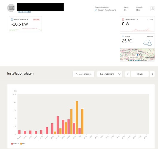

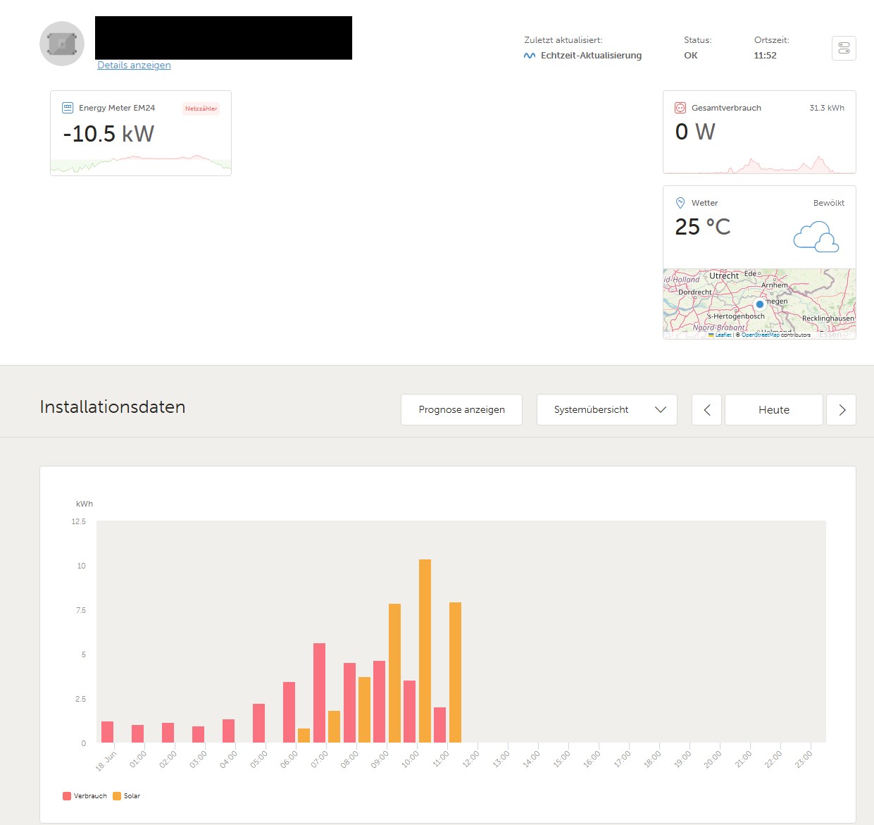

in one of our Installation the PV Inverter tile suddenly disappeared on the VRM looks like this

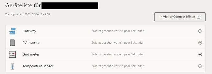

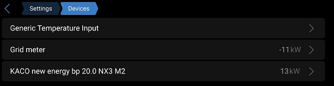

In the VRM Device List the Inverter is shown correctly

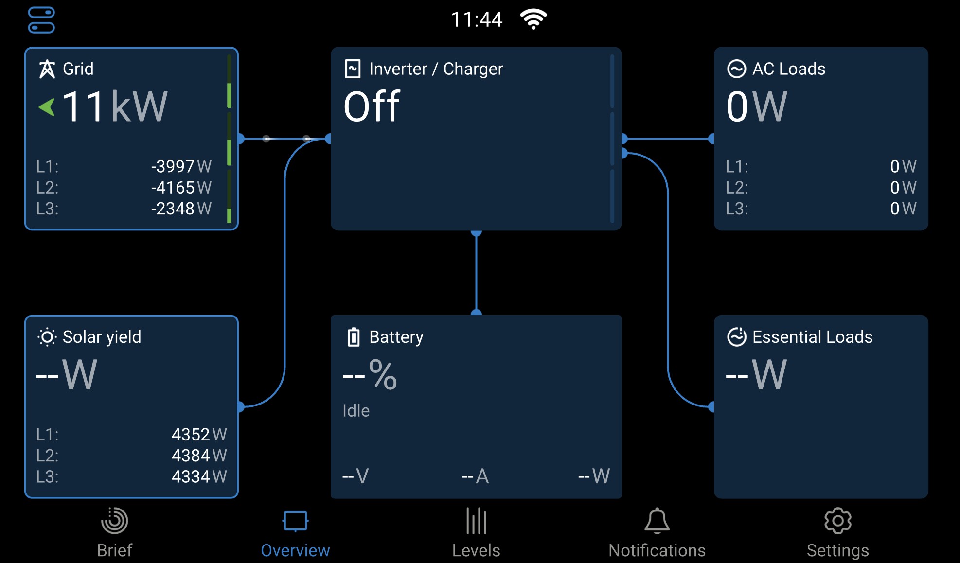

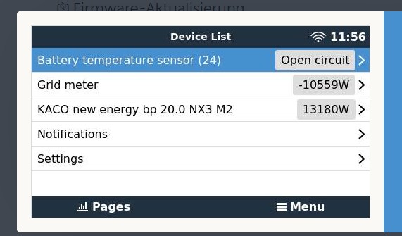

Remote Console V1:
Here the Inverter is not shown.
In the device list the Inverter is there.
Remote Console V2:
Here the Inverter is shown, but without the sum of the individual phases.
In the device list the Inverter is shown.

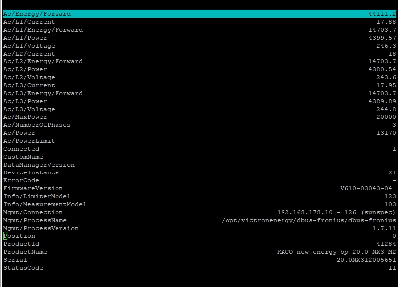

DBUS:
In Dbus the Device looks like always.

@nickdb Thanks for your feedback.
Maybe I didn’t express myself very clearly. I know that it is from Victrons point of view is not a standard Installation because there is no VE Bus device such as Multiplus.
But why this is considered a “modded” system is not entirely clear to me.
The setup is:
  • Gird Meter is a EM24 connected to the Cerbo GX via USB. It is (as usual) automatically deteced by the VenusOS.
  • Thrid Party PV Inverter is communicating to the Cerbo GX via TCP Modbus Venus OS standard way (Sunspec).
  • The Inverter is not connected to the grid meter.
If we’re talking about modified systems, in the sense of running custom scripts to create devices and feed them with data, I completely understand that this isn’t supported. It might work, but it doesn’t have to.
The GX device is indeed modded because we install an OpenVPN client on our systems to capture data and monitor the devices. But I don’t see how this modification has anything to do with the VRM.
