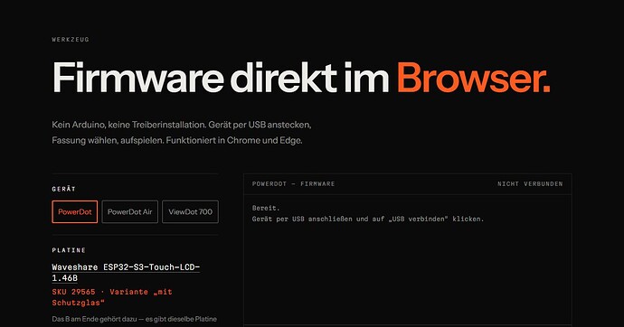

The firmware is free. No account, no subscription, no licence – anyone can download and install it themselves, and install future updates too. It’s installed directly in the browser via USB-C, with no Arduino or drivers:
Chrome or Edge, plug in the device, select the device variant and flash it. In my experience, no one knows how to do this straight away, hence the link.

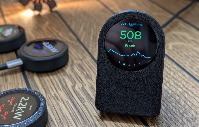

The case shown in the picture fits the PowerDot too – it lets you stand it on your desk instead of having it lie flat. At the front of the picture is the PowerDot Air, the air quality monitor from the same range; the two behind it are PowerDots showing the system values.

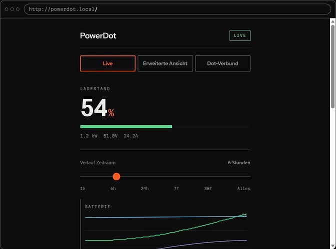

The same values are available in a browser, with history covering hours, days and weeks, and CSV export:

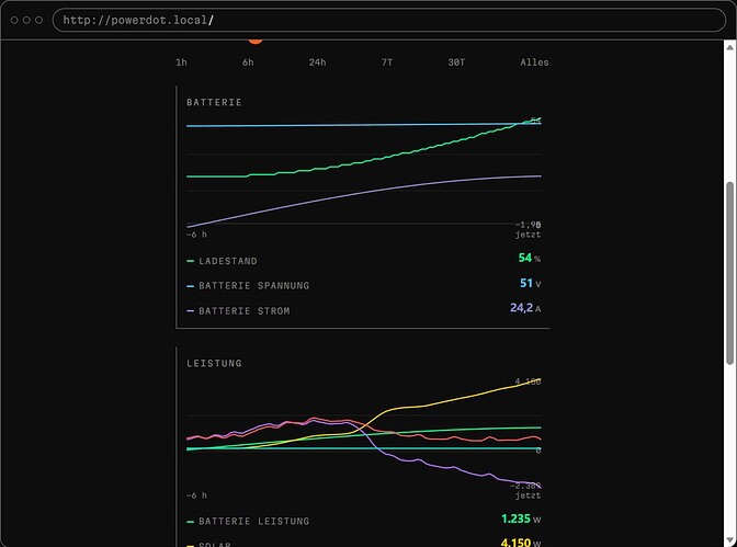

There’s one chart per group, with a shared scale, and the values underneath:
