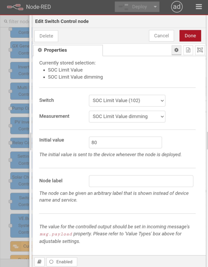

One way is to add a switch control node referring to your virtual switch with an initial value as shown below. It would also be possible to send an inject node to this control node. This does override whatever setting you have input on the console if you redeploy so beware.
That did the job. Thank you for pointing that out. When I do this the “slider” does not change it’s display to show the new value. Is there a way to make the displayed value change?
Thank you.
