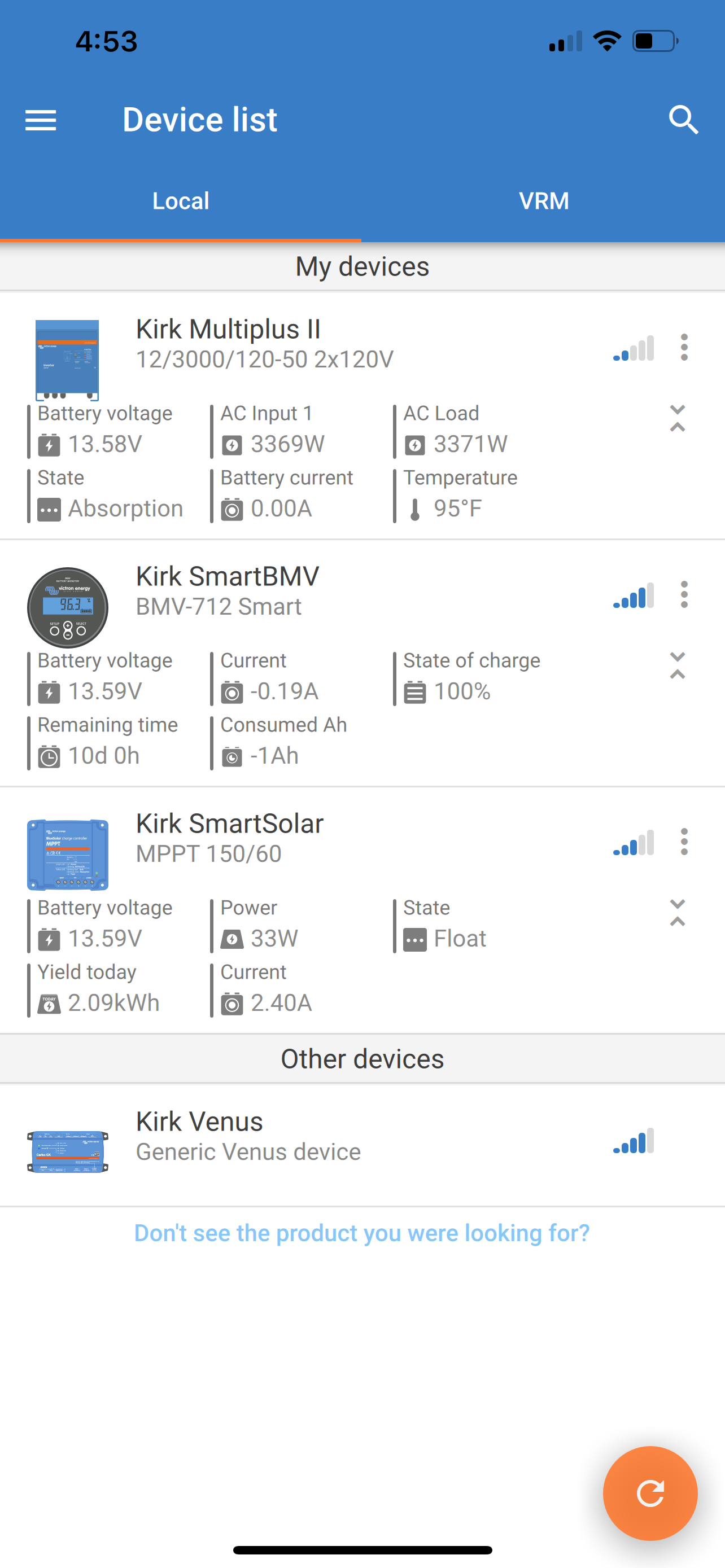

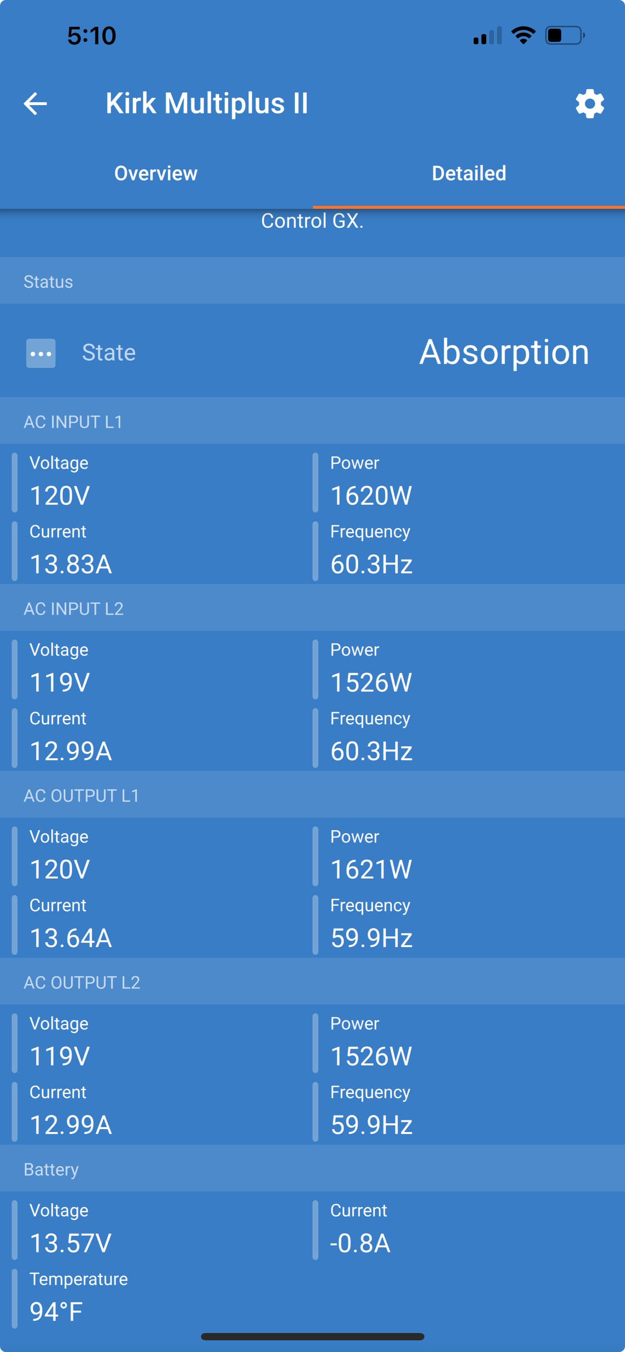

The muliplus II acts like it’s stuck in Solar Wind Priority mode, but instead of the charger in sustain mode, it’s stuck in absorption mode. During the evening, the Multiplus II only charges to a battery voltage is 13.20V (the sustain voltage from the solar wind priority). It never change charge mode.

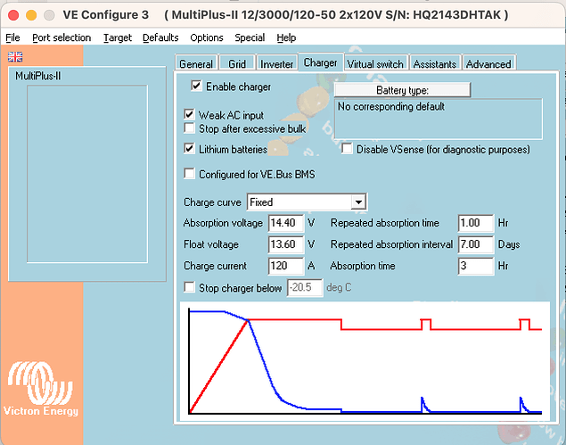

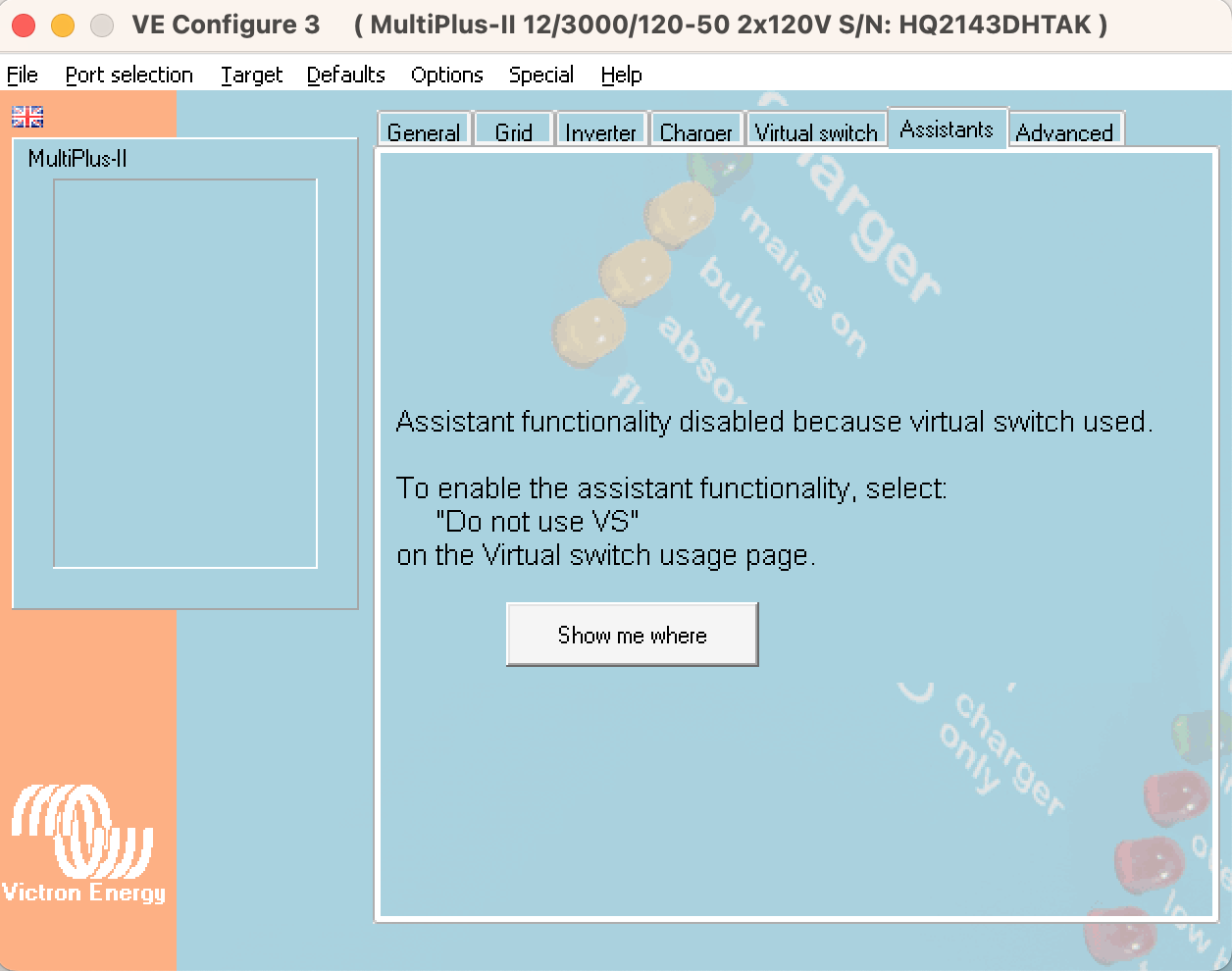

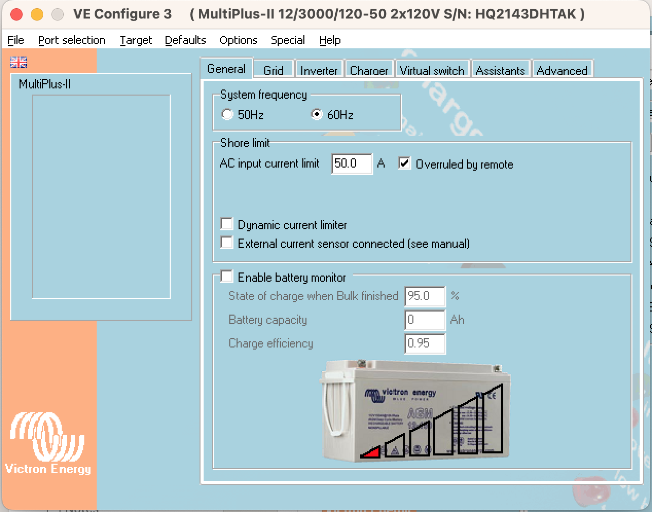

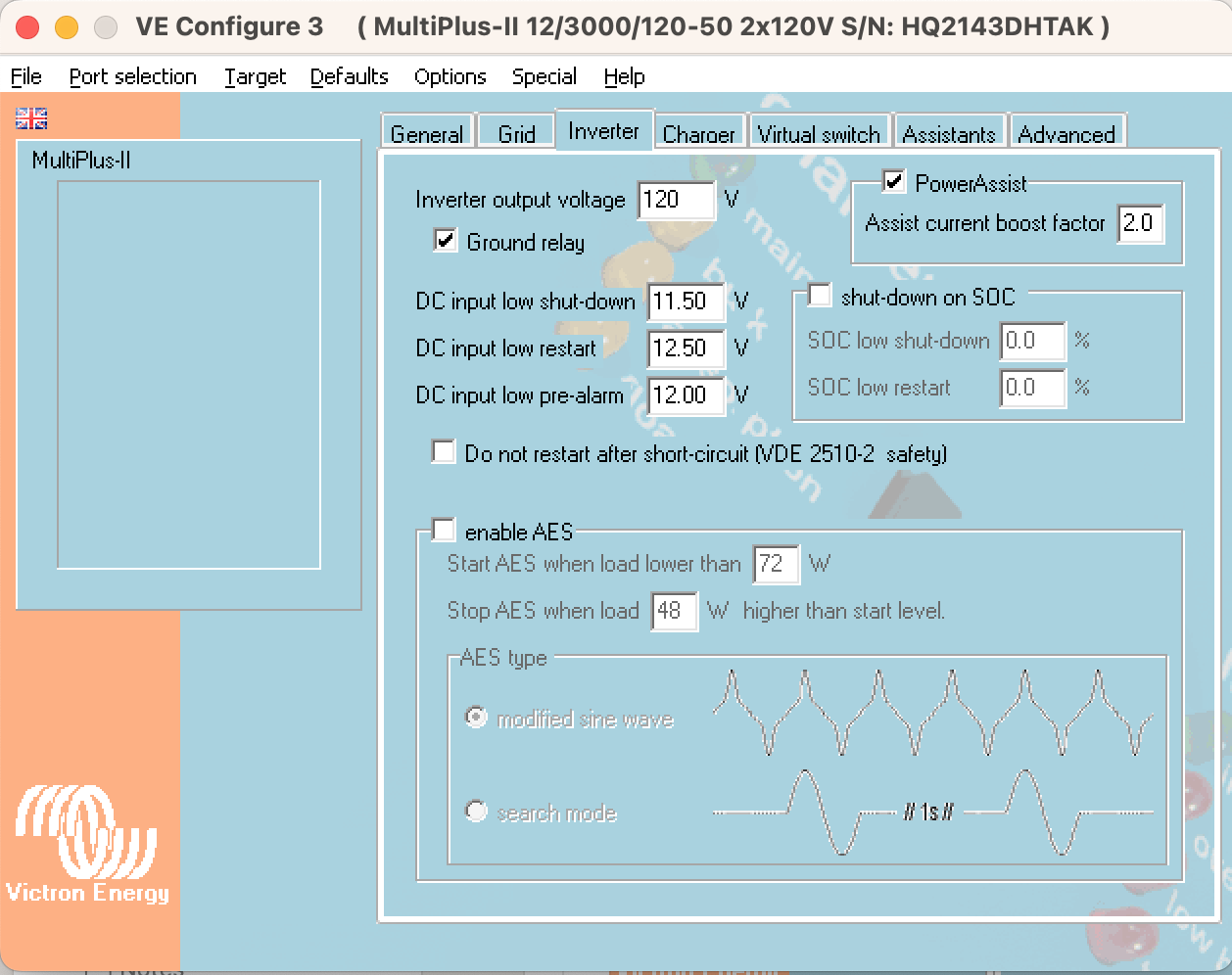

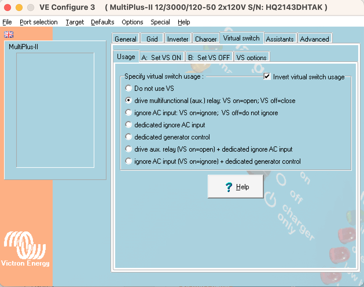

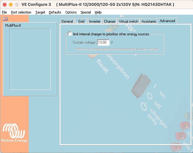

During the day, the solar continues to be treated as priority. It charged the batteries up to 100% and the MPPT is in float. Anytime there’s a load on the system, The Victron Connect shows the current is coming from the battery. The Multiplus II shows zero amps. At times is shows a slight negative (~.8V) then, back to zero. I’ve double checked the configuration using VE Config and the solar wind priority is off. Also the option Wind Solar Priority option to charge to 100% is gone on Victron Connect app.
I’ve toggled the Solar Wind Priority several times, with no change. I did notice in Solar Wind Priority mode the Charge to 100% option is there but when I select it, it says it’s charging, but it doesn’t
