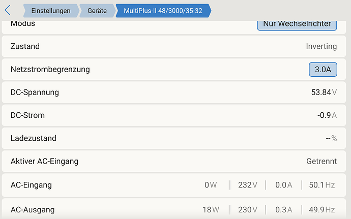

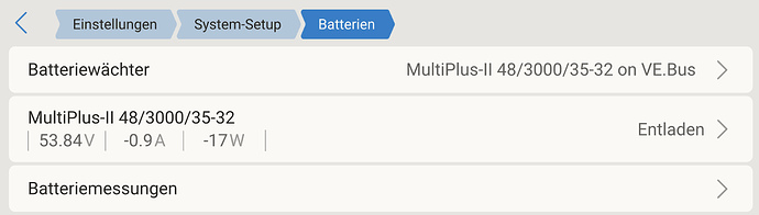

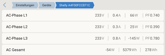

Now for the problems/issues I’ve noticed: The data from the Shelly is updated in the Victron GUI, but the control system is not adjusted accordingly. According to the GUI overview, 48 W is being drawn from the battery, but only 18 W is shown as the AC load. The Shelly continues to draw power from the grid (>100 W) instead of having it balanced by the MultiPlus.

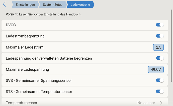

2. When I set the MultiPlus to level II and set the maximum charging current to 0 A and the maximum charging voltage to 49 V under charge control, the battery is still charged (battery voltage >54 V).

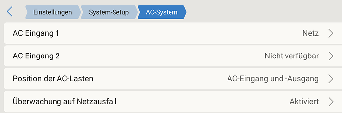

Could you post your MultiPlus settings here, along with your VRM Portal?

Where in your wiring is the Shelly measuring?
No. Only via the GUI
Shelly measures directly downstream of the electricity meter
