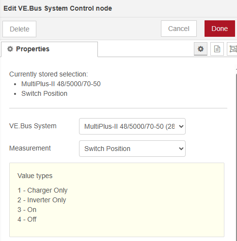

Upgrage firmware to “Venus OS large” version. Open Node-Red trough VRM portal. Use the VE-bus output node. Double click on it. Select your MP2 and select in the second drop down menu (measurement) " Switch position. like this:

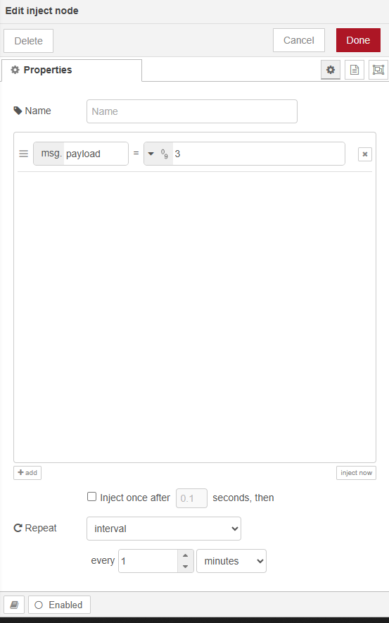

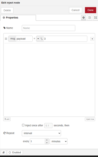

Now select an inject node. Delete the timestamp message. change the remaining meggage to payload instead of topic. And use the number format. And fill in number 3. Set it to injec tonce and set it to repeat every minute. like this:
