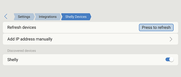

On this screen, I don’t get the option/line: “Discoverd devices: Shelly”
I manually removed the IP address again and added it back and reset it, but that doesn’t change anything either.
Discoverd devices: suggests that it isn’t finding the Shellys.
