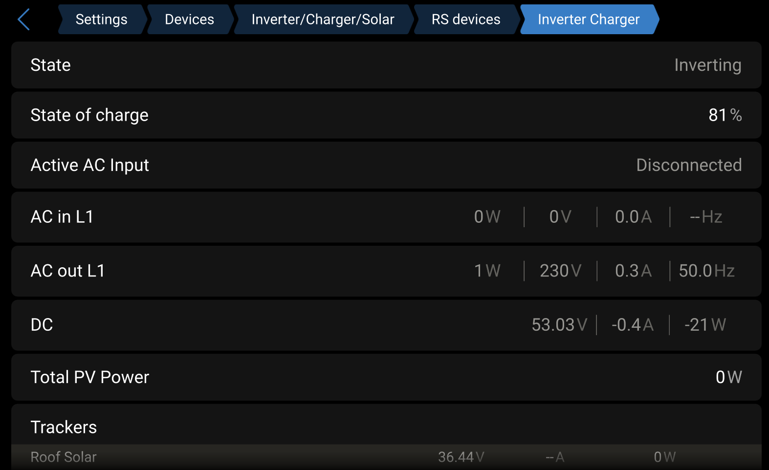

Yes, Multi RS messages are on Cerbo, as can be seen below.
No filters applied on NMEA Reader, but see no messages from RS. Do not even see it as a device in the device list on NMEA Reader.
Log onto Cerbo with a SSH client and use candump utility to see the CAN messages/frames.
That way you’ll be certain and not have to guess anymore.
