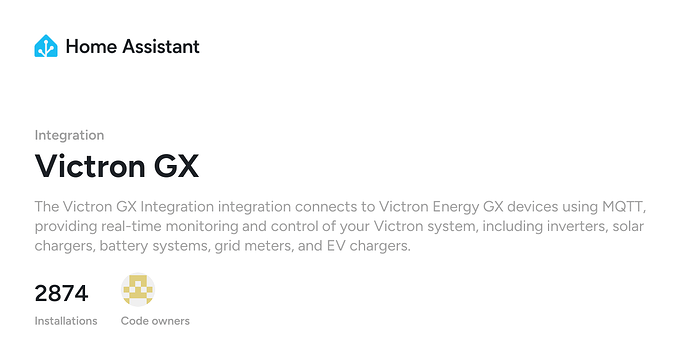

Hi,
the victron gx integration is maintained by a external user, not directly by victron.
Best to raise an issue on the respective github repository:
(The GX itself exports individual trackers power on mqtt already)
