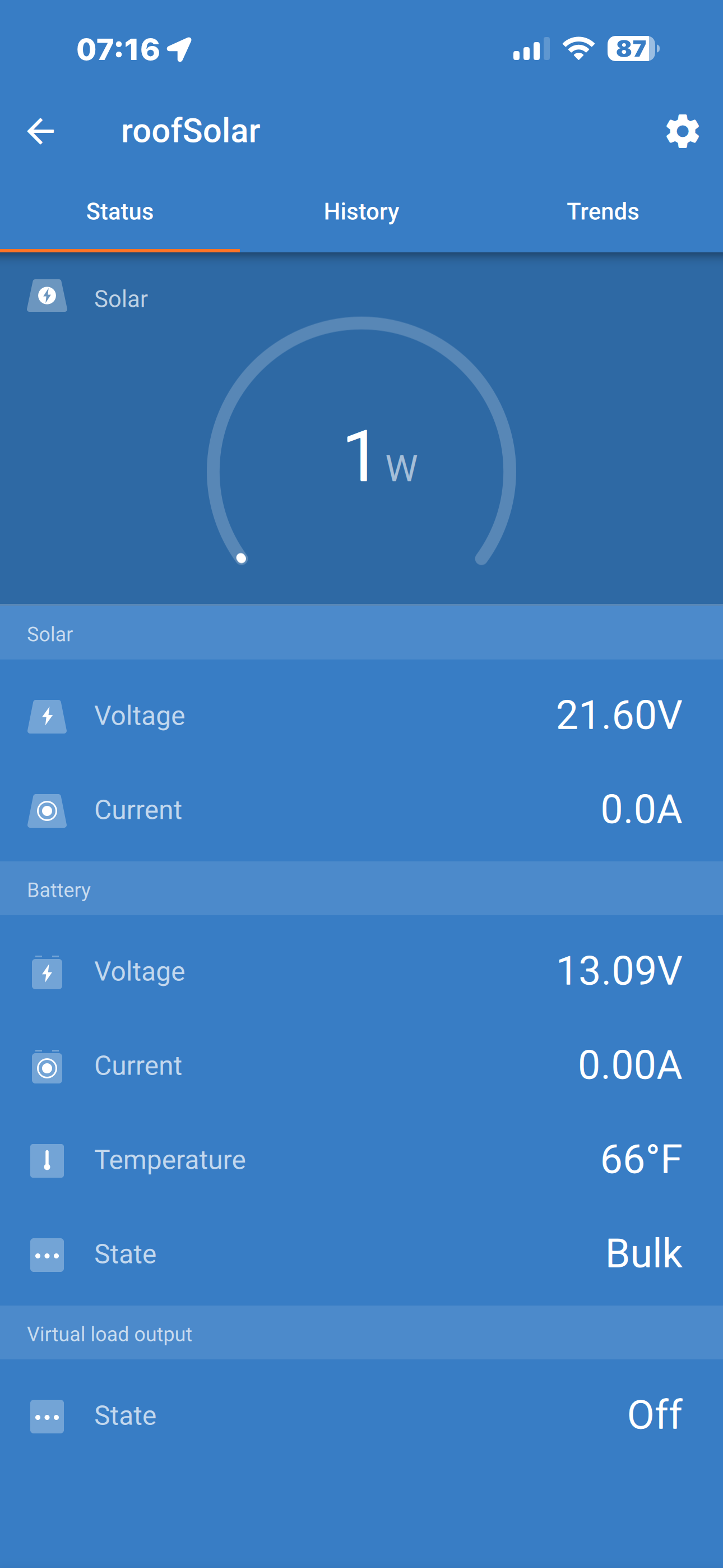

So I recently had a Quattro II installed with a propane generator on our rv.
I noticed we weren’t getting any solar charge when we were off shore power so I had enabled DVCC.
i recently upgraded all of the firmware, including the Quattro, and now the current sense doesn’t seem to provide current to the mppt.
Any settings I should double check?
Wanted to post an update.
Problem solved!
The ve.direct cables from the solar charge controllers were damaged at the Cerbo GX side, and once I replaced them the system began to function as designed. I also realized the installer zip tied the ve.direct cables down so tight that the strain on the cables caused the
damage.
