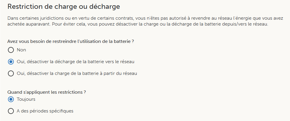

I finally enabled the option not to unload the
battery to the grid
