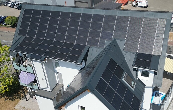

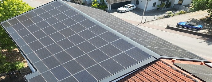

Microgrid 1–3 specs:
  • PV capacity: approx. 60kWp (north, south, façade), bifacial in-roof modules with rear ventilation

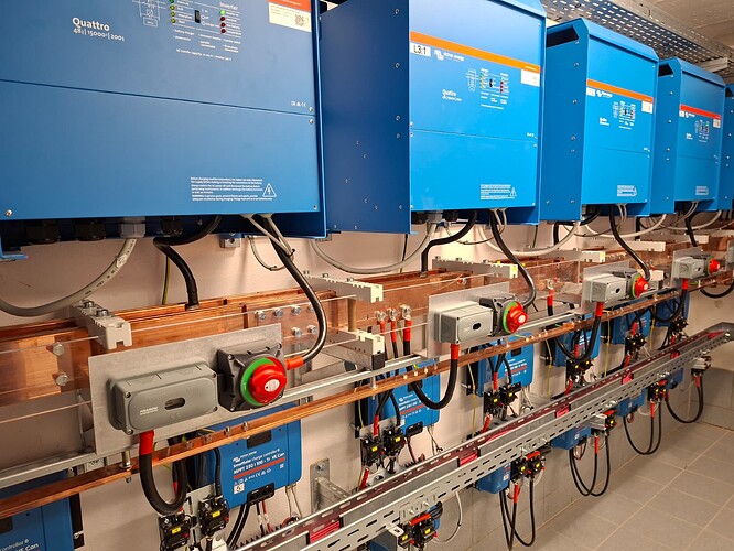

  • Inverter capacity per microgrid: 3x (L1, L2, L3) Quattro 48V / 15kVA, total capacity: 135kVA

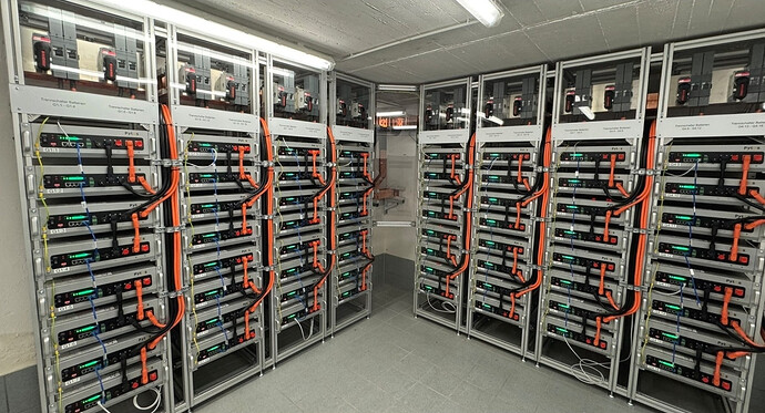

  • Battery capacity: 327,7 kWh
Microgrid 4 specs:
  • PV capacity: approx. 33kWp (south, east, west), bifacial in-roof modules with rear ventilation
  • Inverter capacity: 3x (L1, L2, L3) Quattro 48V / 15kVA, total capacity: 45kVA
  • Battery capacity: 81,9 kWh
