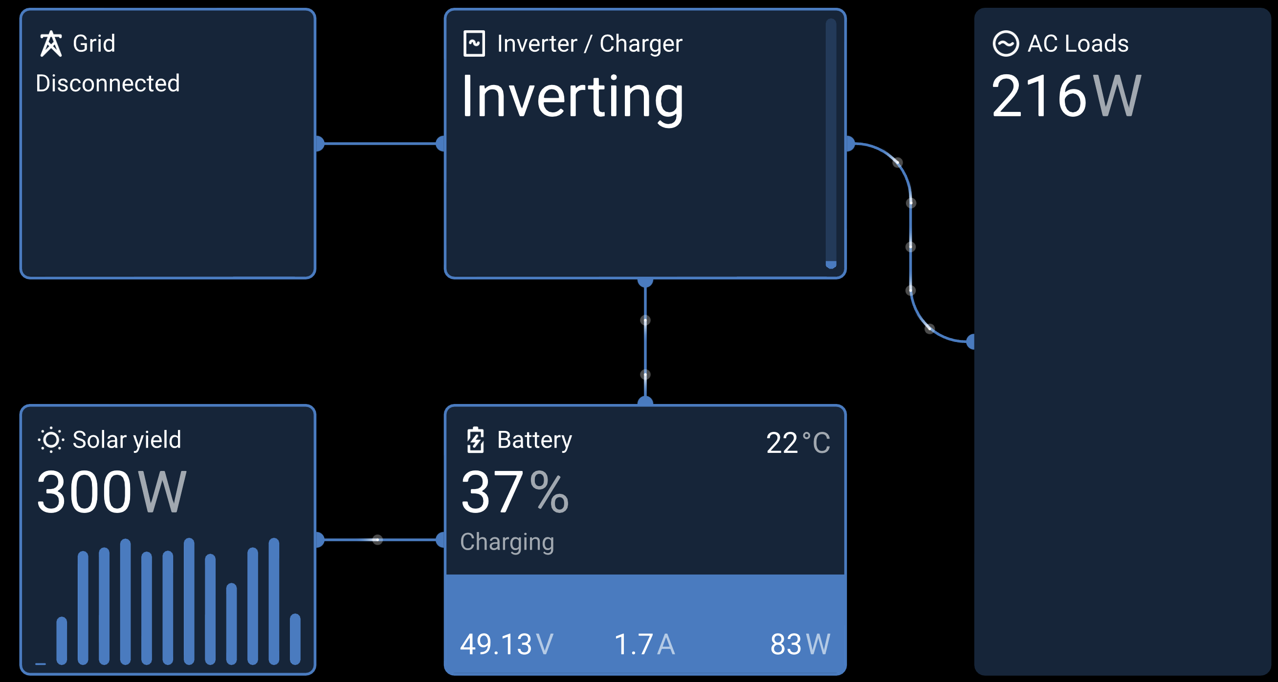

I’m not shure that this is what i want. My system is most of the time disconnected, as PV and Batterie can meet the demand.
I want a message when grid is not available and could not support.
My system is an ESS, 6000kms away to be exact, so every time there is a grid failure and the AC disconnects, it sends a notice and cancels the alarm when the grid returns. There are other parameters and devices to consider like L1 voltage etc. so best you experiment to find one that works for you.

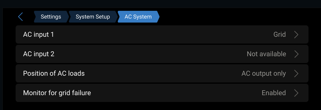

Enabling this will show up on the console, but not message you. Works without internet, but will serve you best if you have a monitor.
