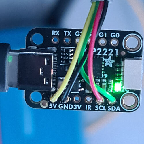

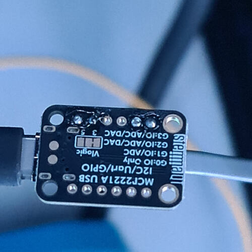

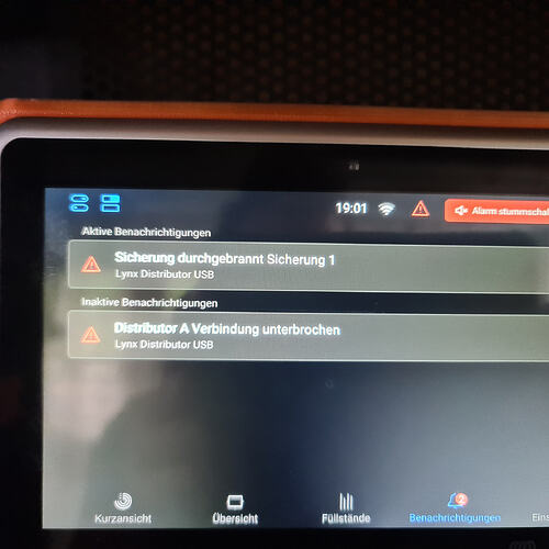

Here is a complete summary of what I consider an elegant way of integrating the Lynx Distributor with the Adafruit MCP2221. It works with the original Victron cable to the Distributor virtually “out of the box” and is soldered on as shown. An English project description is also attached…
