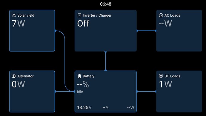

But it does not appear on the main screen:
I have backed it out to the previous firmware V3.60~84 which WAS working but now it no longer displays the SoC in the main screen.
If I go back to the old GUI same thing. Any ideas of what is the fix?
