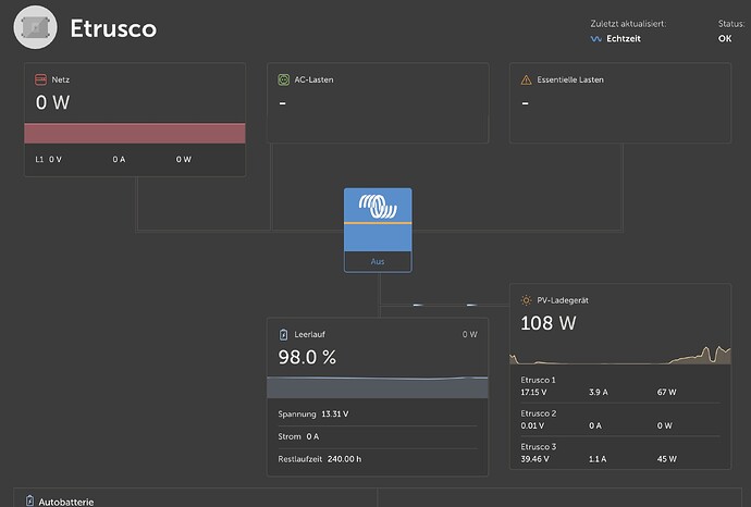

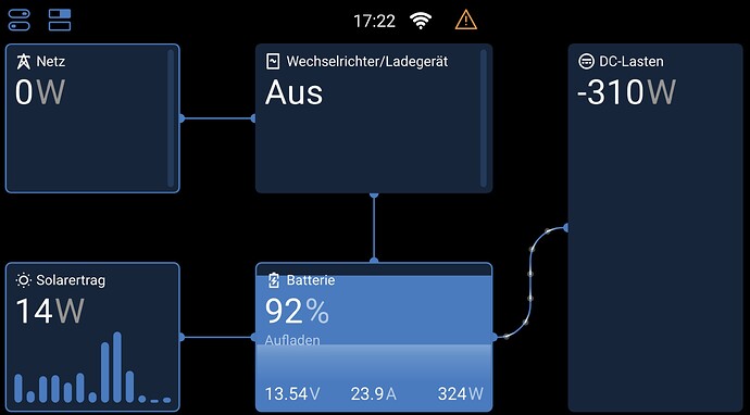

Hi everyone,
As a Node-RED beginner, I installed a Shelly 1PM in my motorhome and also integrated it into my Cerbo via Node-RED. The reason for this is that I can activate/deactivate the shore power and measure the power consumption. I can now switch the Shelly on and off via the Shelly app and the Victron app (as long as shore power is available).
However, I now have the problem that when I disconnect the shore power, the Shelly remains available and continues to display the last values, which means that everything is incorrect. Is there a way for the Cerbo to poll the Shelly and remove it when it is unavailable, then integrate it again when it becomes available? Here’s my code:

Perhaps there is a way to do this, and someone can help me.

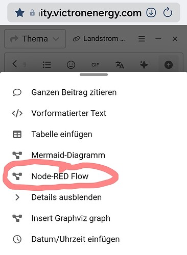

Please either upload the flow here as a file for download or format it as code, OR, best of all, use the option available here in the forum to insert it as a Node-RED flow.
Thanks,
I wasn’t aware of that :+1:

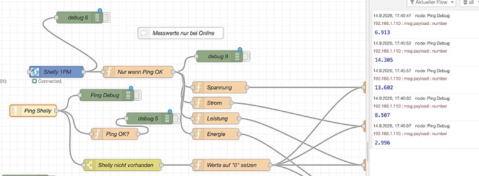

I think there are several possibilities…
For example, you could check in another flow whether the Shelly is available
  • msg.payload.online true/false from the Shelly node
  • via ping (ping node)
  • via MQTT
and then deactivate the flow with the measurement, or set all the measured values to zero; that would of course be easier to do in the same flow.
I hope I have understood your question correctly.

That already looks better; all the values are now set to 0. However, when I plug in shore power, no values are displayed. At the very least, I should be able to see the voltage. I also can’t control the Shelly via the switch in Victron anymore:
the Shelly is in the top left
The error message in the debug output:

Try using ping; you may still need to install the node-red-node-ping palette.
        "id": "6030ab7149722c5a",
        "type": "tab",
        "label": "Flow 1",
        "disabled": false,
        "info": "",
        "env": []
        "id": "52f534f043d024f5",
        "type": "shelly-gen2",
        "z": "6030ab7149722c5a",
        "hostname": "192.168.1.110",
        "description": "Shelly 1PM",
        "mode": "polling",
        "verbose": false,
        "server": "",
        "outputmode": "event",
        "uploadretryinterval": 5000,
        "pollinginterval": 5000,
        "pollstatus": true,
        "getstatusoncommand": true,
        "devicetype": "SNSW-001P16EU",
        "devicetypemustmatchexactly": true,
        "captureblutooth": false,
        "outputs": 1,
        "x": 550,
        "y": 280,
        "wires": [
                "53bcf2985387f01d"
        "id": "53bcf2985387f01d",
        "type": "function",
        "name": "Nur wenn Ping OK",
        "func": "let online = flow.get(\"shelly_192_168_1_110_online\");\n\nif (online === true) {\n    return msg;\n}\n\n// Shelly ist laut Ping offline.\n// Shelly-Messwerte werden deshalb nicht weitergegeben.\nreturn null;",
        "outputs": 1,
        "timeout": 0,
        "noerr": 0,
        "initialize": "",
        "finalize": "",
        "libs": [],
        "x": 760,
        "y": 280,
        "wires": [
                "945f13d078779731",
                "2b71f0988fc0e635",
                "ae8cdd06484514df",
                "a09e33c67e5dba0a",
                "7f7da46310a84c8d"
Sorry, I’d overlooked something—I’ve updated the flow again…
I can’t test it, of course, as I don’t have the same or a similar setup available.

I’ve now imported the flow and got the following result:
I can switch the Shelly on and off using the switch, and with the DC loads I can see the energy currently being supplied by the shore power, but nothing is displayed for Shelly/shore power/mains (top left):
I enabled the debug on “Ping Shelly” and receive messages. Then I added a debug node to “Ping OK” — shouldn’t there be an output there too (if that’s what it’s called)?
Debug 6 on the Shelly also produces output containing, among other things, all the values, but there isn’t any with Debug 9. Perhaps that helps?
As a complete beginner when it comes to AI, I asked the AI for help and have now managed to get it working like this:
I also had the problem that the switch states between the Shelly app and Victron VRM were not synchronised, at least in one direction (Shelly → Victron). That is working now too.

        "id": "c6542db06eb33100",
        "type": "function",
        "z": "38978352000de3ce",
        "outputs": 1,
        "timeout": 0,
        "noerr": 0,
        "initialize": "",
        "finalize": "",
        "libs": [],
        "x": 590,
        "y": 200,
        "wires": [
                "bcd43659726eb68c",
                "37c579afd89fcea5",
                "75a6ce8b51949642",
                "fec5f097cb1f66dc",
                "5fd351c4b08bc3a7",
                "0c2b279951cd7fd4"

        "id": "3bc43160ddfcb85f",
        "type": "switch",
        "name": "Shelly nicht vorhanden",
        "property": "payload",
        "propertyType": "msg",
        "rules": [
                "t": "false"
        "checkall": "true",
        "repair": false,
        "outputs": 1,
        "x": 550,
        "y": 440,
        "wires": [
                "d3f1719cc10f180f"
        "id": "d3f1719cc10f180f",
        "type": "function",
        "name": "Werte auf \"0\" setzen",
        "func": "msg.payload=0;\nreturn msg;",
        "outputs": 1,
        "timeout": 0,
        "noerr": 0,
        "initialize": "",
        "finalize": "",
        "libs": [],
        "x": 830,
        "y": 440,
        "wires": [
                "011b7e71cc2dc7ec",
                "70168dcc56dc2139",
                "5ba0c3d46554fb89",
                "3c9c90c6555a274c"
        "id": "b8074ef1c0114d96",
        "type": "ping",
        "protocol": "IPv4",
        "mode": "timed",
        "name": "Ping Shelly",
        "host": "192.168.1.110",
        "timer": "5",
        "inputs": 0,
        "x": 320,
        "y": 300,
        "wires": [
                "9c69995959f2c2af",
                "94d44401f2bb78bf",
                "3bc43160ddfcb85f"
        "id": "9c69995959f2c2af",
        "type": "function",
        "name": "Ping OK?",
        "func": "const online = typeof msg.payload === \"number\";\n\nflow.set(\"shelly_192_168_1_110_online\", online);\n\nmsg.online = online;\n\nreturn msg;",
        "outputs": 1,
        "timeout": 0,
        "noerr": 0,
        "initialize": "",
        "finalize": "",
        "libs": [],
        "x": 530,
        "y": 360,
        "wires": [
                "273bc2de0f0f4782"
