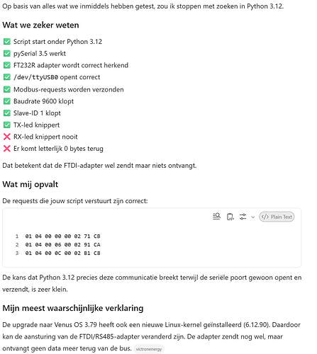

I tested various script modifications, but it is not related to the upgrade from Python 3.8 to 3.12.
The PV meter is detected and connected, but does not return any data.

Screenshot of my Copilot assistant.
