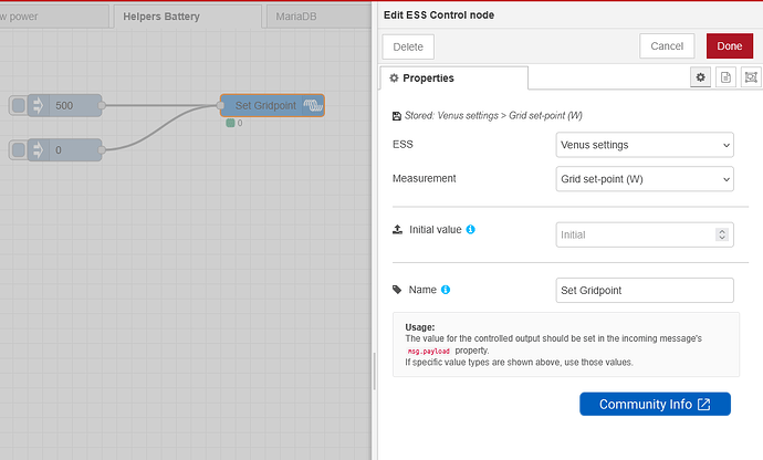

I’m using the standard ESS control node (simple test flow below)
It doesn’t work when DESS is active
Thanks… I was overcomplicating things. Indeed, switch off DESS and control the grid setpoint. I don’t need to do anything with HUB4 at all.
