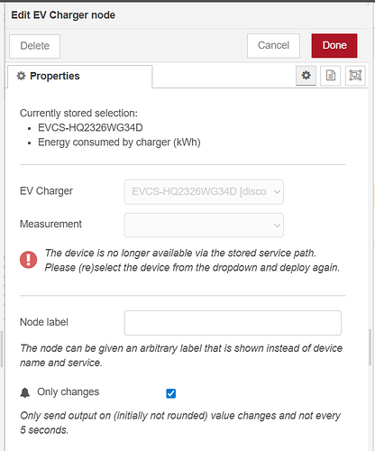

EVCS node disconnecting (The device is no longer available via the stored service path.)
EVCS node shows disconnected which states the D-bus path is not excisting.
After while comes back & disconnects then again.
EVCS can in mean time be accesed normally & shows up in the overview.

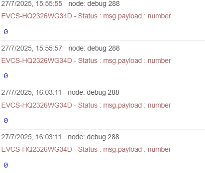

Follow Up → Looks there is a relation with “Lost Connection to Server” ; after reconnecting the node is becoming back connected.
Working on latest stable firmware.

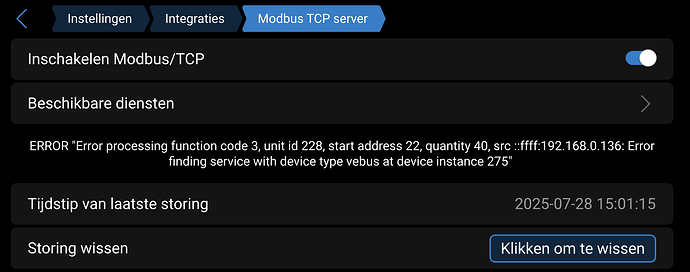

You will need to check the GX logs, see if either nodered or the GX is restarting for some reason.
don’t know where to find the GX logs but found this error on modbustcp where the charger is connected with
and also this one
Last reboot of the GX is from yesterday (timing updating to last stable version firmware).
