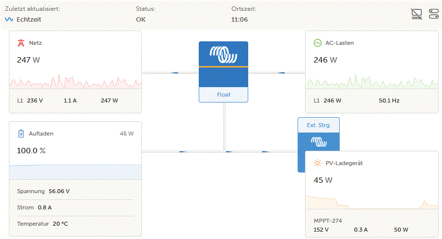

ESS system: No grid feed-in possible, and the load isn't being supplied by PV
Hello everyone
My ESS system:
1-phase MultiPlus II GX 48V
4 Victron GEL batteries
1 Victron MPPT 250 | 60
Settings:
ESS: DC-coupled feed-in
Setpoint -200W
Minimum SOC for discharge 50%
I can’t get it to feed power into the grid. The MultiPlus regulates to 0. No matter what I set, whether “BatteryLife” or “No BatteryLife”, it supplies the load from the grid, including losses, and only uses the solar power generated to charge the batteries. The battery is currently full. The MPPT switches to minimum.
The system was checked by a professional. He can’t find anything wrong either.
What can I change to make this work, or does it generally not work with lead-acid batteries?
Thanks very much for your help.

Hello
I’ve now restarted VE-Configure 3 to save the configuration. It told me there was a new version available. It also required an update to the ESS Assistant. After that, I loaded everything again and now it works. It’s feeding power into the grid at full capacity. My setpoint of -200 W doesn’t seem to matter at the moment, though.
I didn’t have this update, 90.04.248, the day before yesterday.
Thanks anyway!
The switch was already in the correct position.
