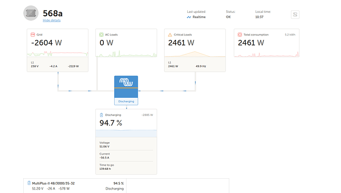

Ive been trying for a while now to limit the amount of charge/discharge current for ESS but it doesn’t appear to be applying properly. Im using simple ESS with a MP ii, ET112 and Venus OS 3.52. DVCC is set to off. Here you can see that ESS is set to charge/discharge at 250w for testing but the actual usage is far higher:
