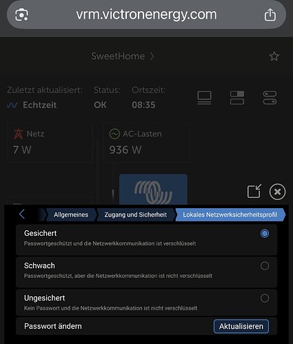

can you tell help to reset my password
Hello,
I reset it here:
