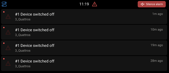

i have a 3-phase installation with 1x Quattro 15k per phase.
Ever since installation a few days ago I am getting frequent errors #1 Device Switched off.
The intervall between the errors is rather random. sometimes we can go a whole day without errors, sometimes we get 15-minute intervals.
In another thread here in the community someone had a similar problem, turns out it was a hardware fault.
( MP2 device switched off periodicaly )
  1. How can I troubleshoot this issue? Is there a more detailed logfile somewhere? All I see are the meager error messages in the GX device.
  2. In case it is a HW fault: How can I identify which one of the 3 Quattros is the defective device? the 3-phase system always switches off all 3 devices at the same time.
thanks,
Olli

I am aware of the ve bus manual and I have already set up automatic alarm monitoring on VRM for this system.
So I should be getting info from VRM or GX (or the Quattro device itself?). But nothing yet, except for the screenshot I posted.

More Info:
  • Problem occuring rather often, see screenshot from VRM
  • Nothing in the logs
  • No temperature problems
  • System cannot be overloaded, all it does is constantly charge 25kW from a CHP to the batteries.
