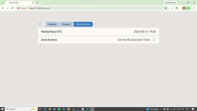

Date and time on the EasySolar II GX

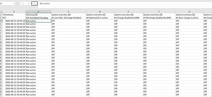

The time has now been updated, but I’m not sure whether the region for Peru will be the same, because the data isn’t being recorded with the correct time. I set it to record data for a 1-hour interval. If anyone knows how to configure this, could you please tell me what steps to follow?
THE DATA isn’t being recorded according to the time I selected, for a one-hour interval. If anyone knows the correct configuration, could you please help me?
Select the time that matches yours or the one you want. If the one you currently have doesn’t match, use the previous or the next one, even if the description isn’t what it might seem.
