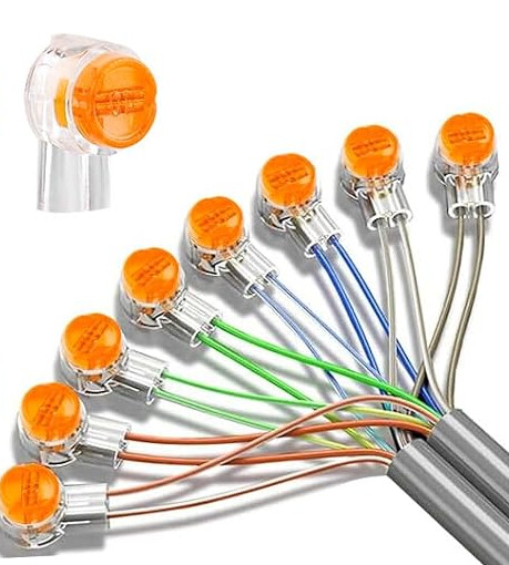

Have a look for “Scotchlock” … they’re grease-filled insulation-displacement connectors …
