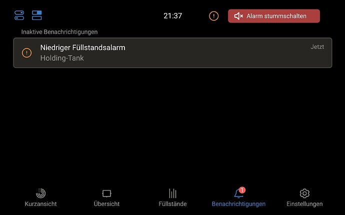

Bug report v3.80~51: Tank Alarm low level even though no alarm is activated

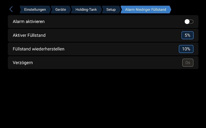

When the EkranoGX is restarted, a Tank Alarm is reported even though no Tank Alarm is enabled for Low Level.
Hi,
Thank you for reporting this. This is indeed an error in the BLE sensors service and we are working on a fix.
With kind regards,
Thiemo van Engelen
Should be fixed in v3.80~53.
