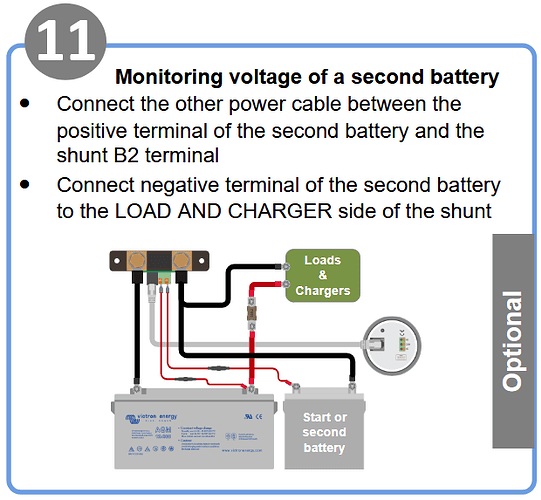

Have you actually connected the starter battery to the aux input and then set up the aux input as starter battery.
See Section 3.6.1 in the manual for wiring the starter battery and Section 4.6.4 for setting the aux function.
For the relay see Section 7.3 which explains all the features and yes, you can use the relay function based on the starter battery voltage.
I have just checked and it looks like I have the “Basic” connection without the starter battery. Can I send you an image of the connection just to confirm?
So can you explain why on the dashboard it shows the starter battery as 0.03V. Is that a discharge of the starter battery? Thanks.
If you don’t have the starter battery connected to the BMV than that 0.03V is just a measurement error.
