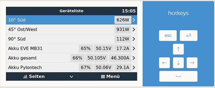

Why do I correctly see two different battery sets in the old interface and in the VRM, but there is only one in the NEW UI?

It’s the same for me … it’s probably due to the implementation of the Battery Aggregator … it works better in the old V1 …

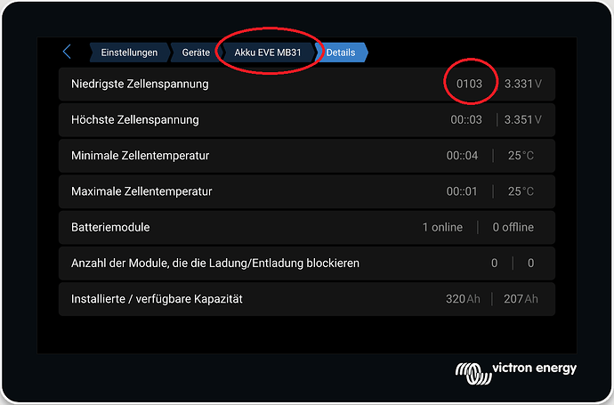

In V2, it mixes up the detection of Pylontech and JK … as you can see from the cell number …

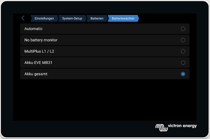

Have you checked if it is Visible

It isn’t displayed for me, anyway … but it is evaluated in the background … see the cell information further up …
“Total battery” is the aggregator!!!
… But you’re also using two JK BMSs in parallel, rather than a Pylontech and a JK …
