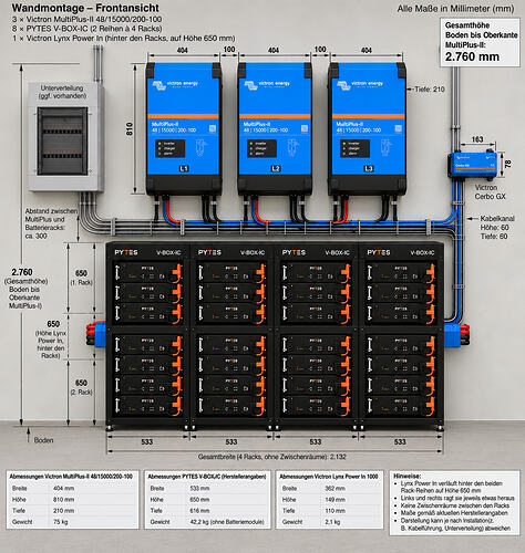

I would like to build a 3-phase system with 3x MultiPlus 15000. I
would like to be able to disconnect the Multi units from the Lynx busbar
using a battery switch.

Hey, it’s going to be a very large system. 24 batteries at 5.1 kW each.
