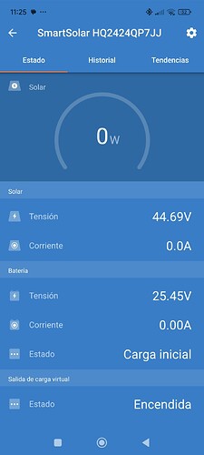

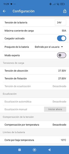

I have an MPPT 100/50 controller which, after being programmed, starts up normally but does not charge — 0 W.
Everything is configured and there are no errors, but it still does nothing.
The configured settings and the controller status are shown below.
I look forward to your replies.
The usual problem is often reversed polarity on the array
The other possibility is that the temperature is under 10°C and so charge won’t start? Is it cold there?
