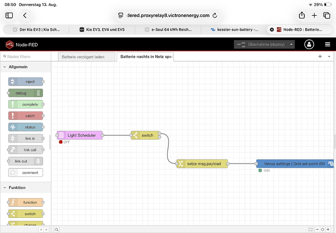

I want to feed 1 kWh of electricity back into the grid every day from 8 p.m. to 11 p.m. and from
5 to 7 a.m.
In Red Node, this never works properly. The system does start, but then it doesn’t stop. Is there another way to do this?

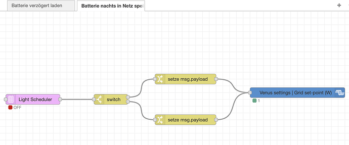

Your scheduler isn’t necessarily the problem; it’s simply the setup:
what exactly do the two switch nodes do?
If you set it to active at -500 W, then of course you also need to set it back to active at 0 (or 30, or whatever you configured) two hours later.
That’s not the case here, in my opinion (without knowing the settings in the switch nodes), based on how you’ve set it up!

The “Light Schedular” lets me set it to turn on and off from 8 to 11 p.m., and then from 4 to 7 a.m. It always turns on, but suddenly it no longer turns off since I got this simple version.
These settings work, although the problem is that I’m not allowed to set the power draw in the second node to 0; otherwise, the battery only discharges to a maximum of 20%… So I always have to draw around 10 watts from the grid (which I don’t want to do).
That’s why I’m also trying the approach with the inject nodes, so that the red node only intervenes when I want to feed power from the house into the grid — and not otherwise.
Here’s the diagram with the scheduler
