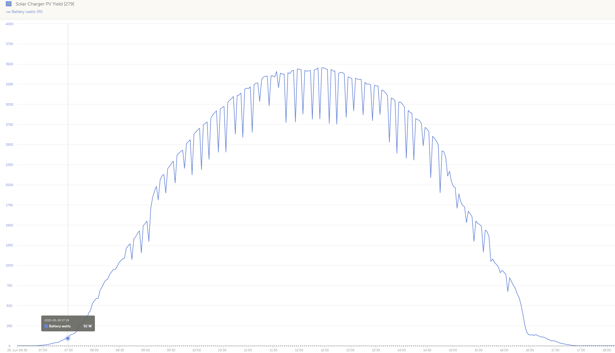

I notice deep dips on the PV yield on one day compared to the dips on the (basically identical and cloudless) previous day. (I have seen this before, but being recently retired, I now have the time to attend to it :))

Yes the dips are normal.
There is re tracking every 10 minutes or so even if it is sunny day.
Sometimes the logging catches it sometimes it doesn’t, even on the 60secpnds interval, which is why you see it then maybe you don’t.
