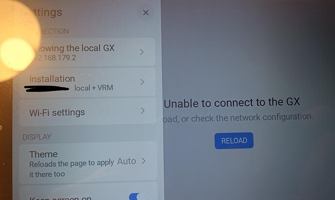

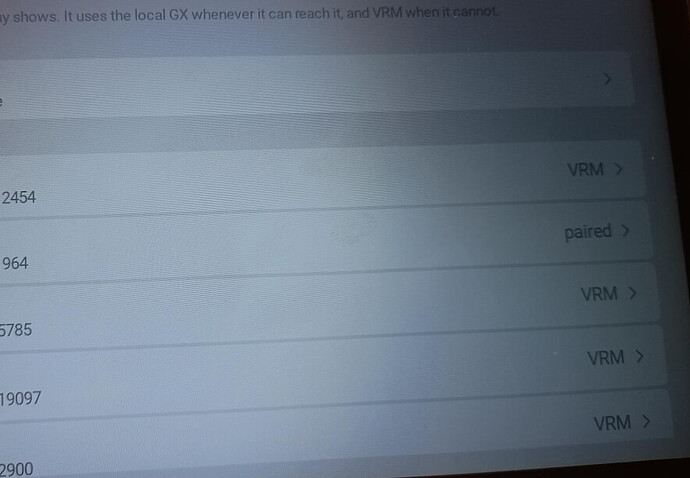

Lenovo TAB M9 with Android 13
I only ever get the local GX Console displayed.
For every VRM Remote Console selected via Installations, I get either the local Remote Console accessible over Wi-Fi, or the error message Unable to connect to the GX if there is no GX device running on that Wi-Fi network.
Selecting another, remote Remote Console doesn’t work.

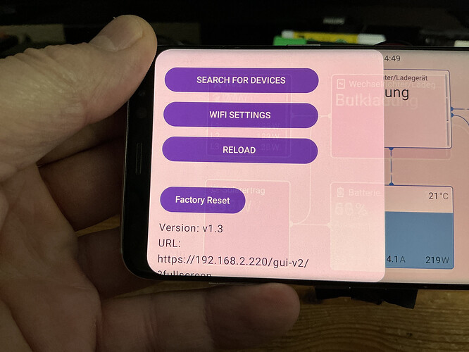

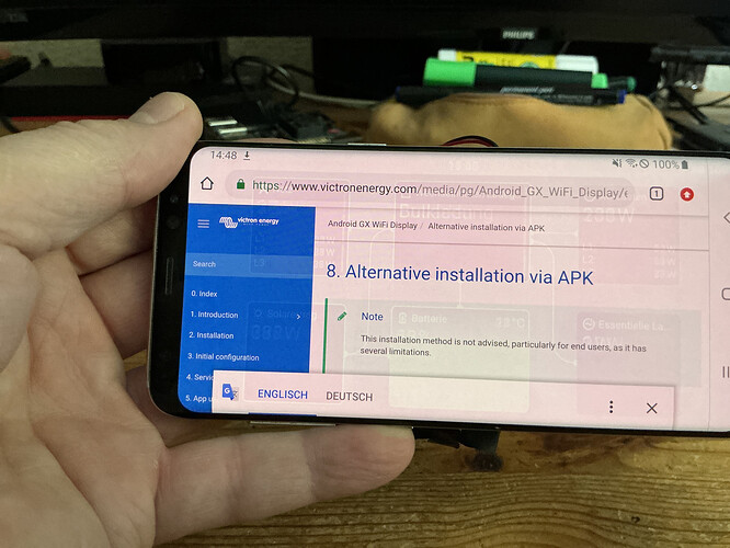

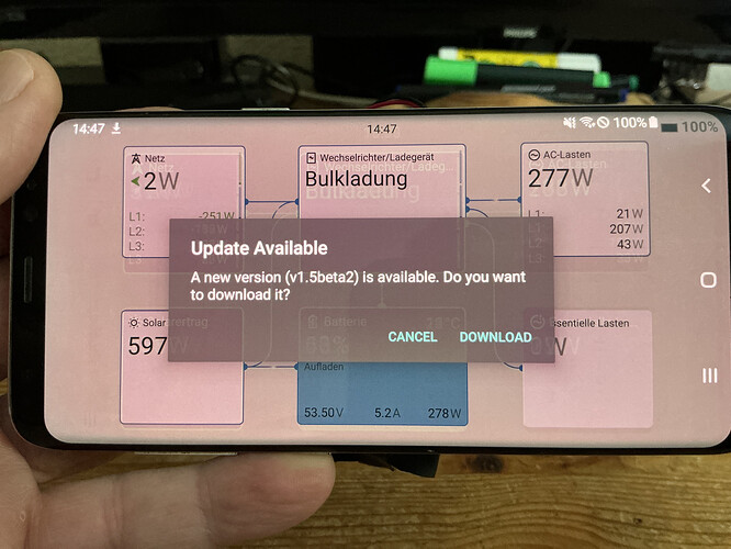

Good day, I’m now running version 1.3 and I’m also being offered the beta update option. Version 1.5.2 is found and offered for download. However, I always end up on the official website 8. Alternative installation via APK
And basically download version 1.3 again. Kind regards
When the app is installed via the APK file the self-update mechanism is not available, that is why you see “download” instead of “install”. In the notifications bar of the phone I see a download icon, that is probably the apk that has been downloaded. So you need to open the notifications bar and then open the file.

Thanks, and yes, there was an APK in the download, but it was always version 1.3.
