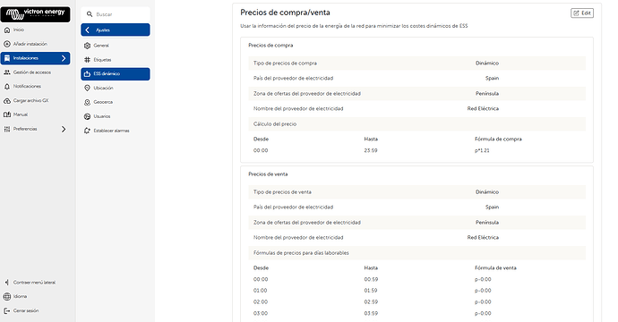

I recently discovered this community, and I’m asking for help, and I’m happy to pay for it if necessary. The thing is, I have my setup working perfectly with my Ekrano and my MultiPlus-II. I’ve got ESS Dynamic enabled and everything is working fine, including the PVPC purchase price information downloaded from Red Eléctrica. BUT THE OMIE PURCHASE PRICES! I have to enter those manually every day, which is a real pain.
I’m looking into getting Node-RED to do that job, but it’s beyond me and I can’t get it to work. If anyone would be willing to do it for me or guide me through it, I’d be very, very grateful.

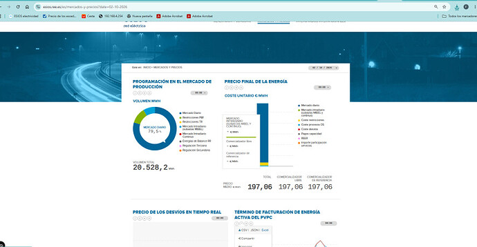

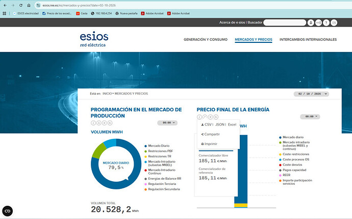

The data is on this website Esios Red Eléctrica. It includes both the purchase data, called PVPC, and the sale data, which is listed as PRECIO FINAL DE LA ENERGÍA. There are several ways to access the website or download files. To use the API, you need a token, which you can get from the website in just a few minutes.
My goal is to check the prices every day at 21:00 and feed them into the ESS Dynamic prices. At the moment, the purchase price is p*21 to add taxes, which works perfectly, but I can’t do that for the purchase price because it’s p-X, and X isn’t fixed; it varies. So the only way is to feed the “PRECIO FINAL DE LA ENERGÍA” into ESS Dynamic as my sale price.

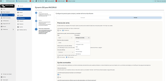

In reality, none of what I’m describing would be necessary if someone at VICTRON ENERGY had a light-bulb moment! :thought_balloon::light_bulb:! And, just as the suppliers (all of them purchase prices) appear in the list, they added one more: OMIE PRICE, https://www.omie.es/. If they added that price, we’d have automated selling prices without having to do anything else.
The truth is, I don’t know how to request this small improvement from Victron. It would be great if someone could escalate it or tell me how to suggest the improvement to the relevant department.

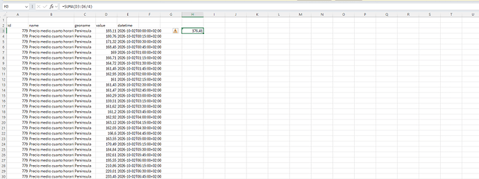

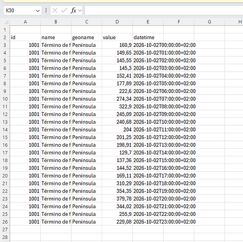

I’ll give you some information, although my knowledge is very limited. There’s a section on the website for the API with a token; it’s in English. API e·sios Documentation I assume the information we need is in one of those files.
I download it using the Excel option, and in another option manually.

Purchase prices “PVPC” for 02/10/26
Selling prices “OMIE” for 02/10/26
