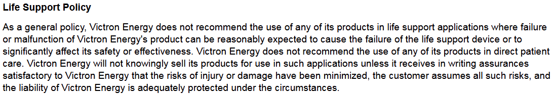

Since it isn’t quite perfect, Victron also states in its warranty terms, for example, that the devices should not be used for life-support machines.

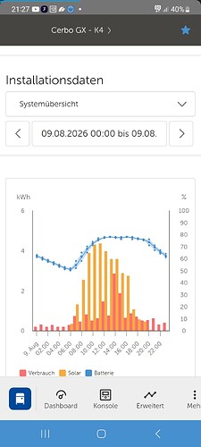

Here’s a screenshot from my neighbour with 55 V (PV hasn’t been integrated into Victron yet). This shows what I mean.
