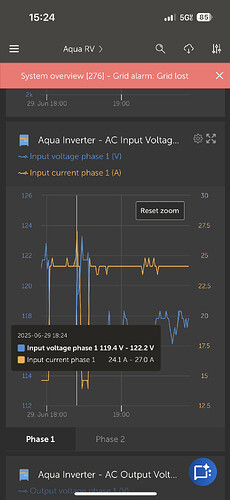

In the inverter menu it showed a discrepancy that the multi’s input was 24A, but my energy meter & power watch dog disagreed.

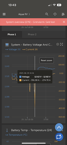

Battery current to show when assist kicked in.

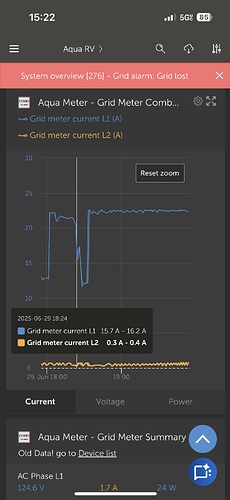

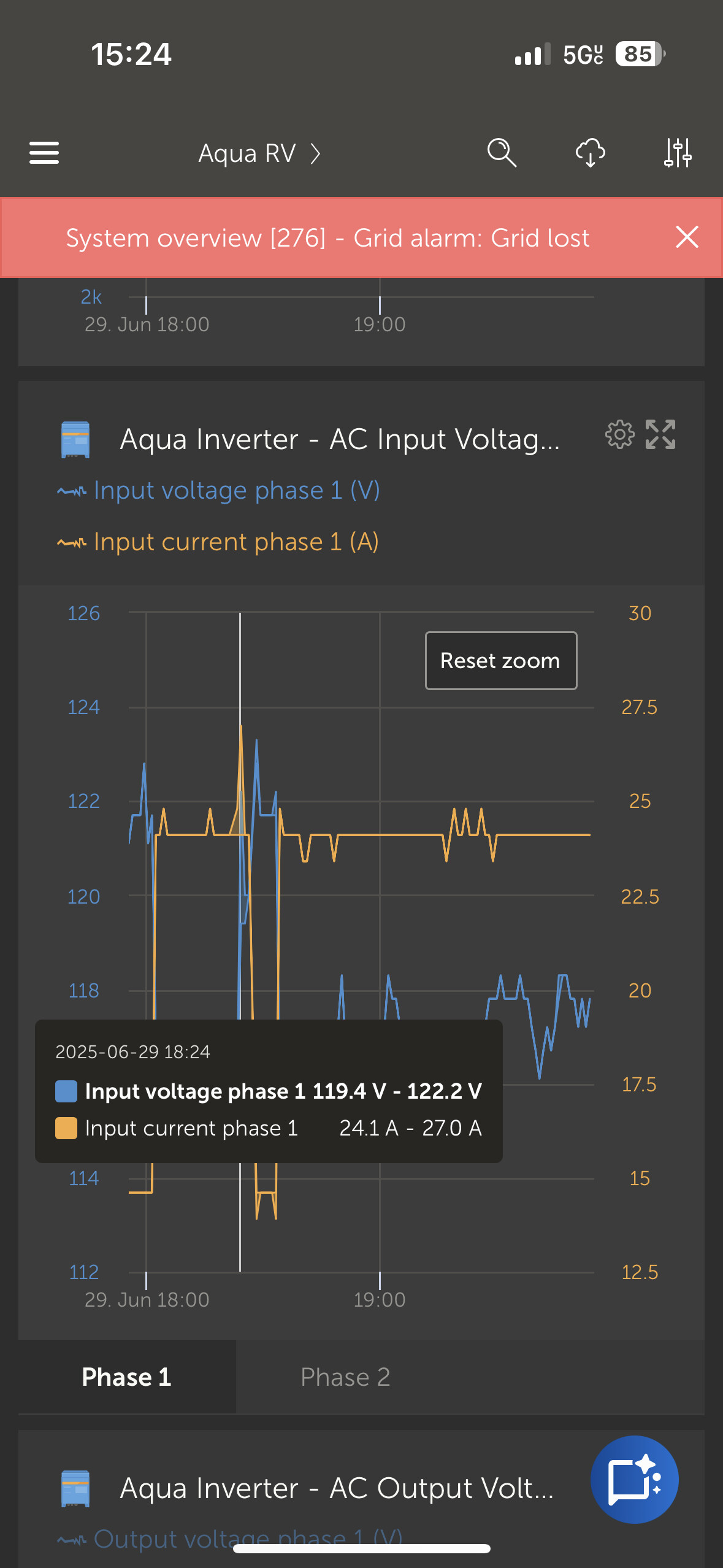

Multiplus ac in showing 24-27 “false amps”
Grid meter showing actual input of only 15amps
